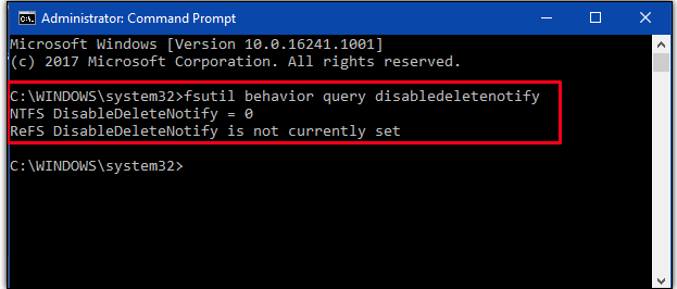

To ensure that TRIM is active and that the process is working properly, we have created a PowerShell script that is deployed using our MDM. This script creates a recurring validation task from TRIM. After this, we access the logs obtained by our SIEM for analysis.
The results of this command can be read as follows:
Description
NTFS DisableDeleteNotify = 0 This specifies that SSDs with NTFS has TRIM already enabled.
NTFS DisableDeleteNotify = 1 If the status displays the Value as 1, it states that SSDs with NTFS has TRIM disabled.
NTFS DisableDeleteNotify is not currently set This status illustrates that TRIM support will automatically get enabled when an SSD with NTFS is connected.
ReFS DisableDeleteNotify = 0 The 0 with ReFS denotes that TRIM support is enabled for SSDs with ReFS.
ReFS DisableDeleteNotify = 1 Here the Value 1 with ReFS signifies that TRIM is disabled for SSDs with ReFs.
ReFS DisableDeleteNotify is not currently set This specific result interprets that TRIM support will itself be enabled when an SSD with ReFS is connected.
