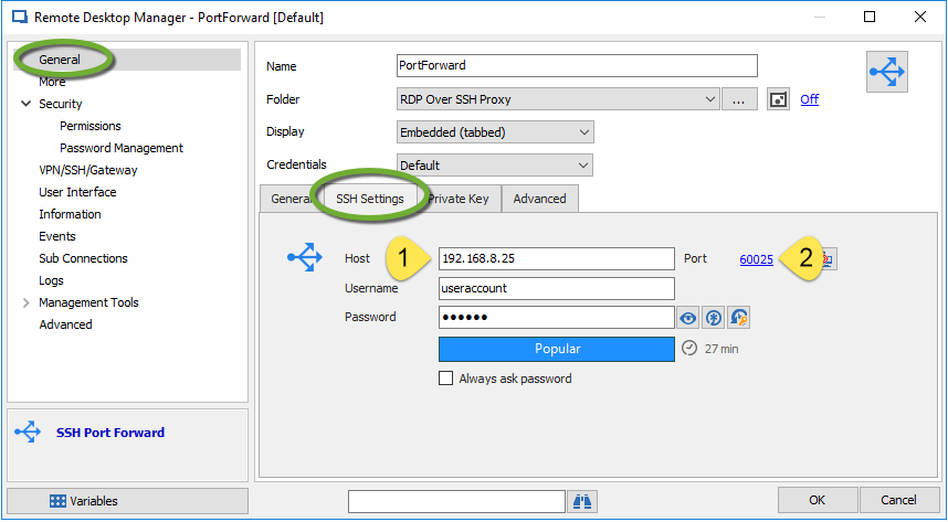

Step 1
Create a new SSH Port Forward entry in RDM by clicking Generalon the side menu, and then entering your SSH information in the SSH Settingstab. You will need to enter the IP address of the SSH Gateway Server, and the port number of the SSH Gateway Server.
Step 2
In the Generaltab, click on the Plusto create the dynamic link that will be used for every proxy tunnel. The source is **127.0.0.1 **and the mode is Dynamic. Remember that the source port must be the same as the one configured in each proxy tunnel entry.
Here is the PowerShell script you’ll need to enter to create this entry:

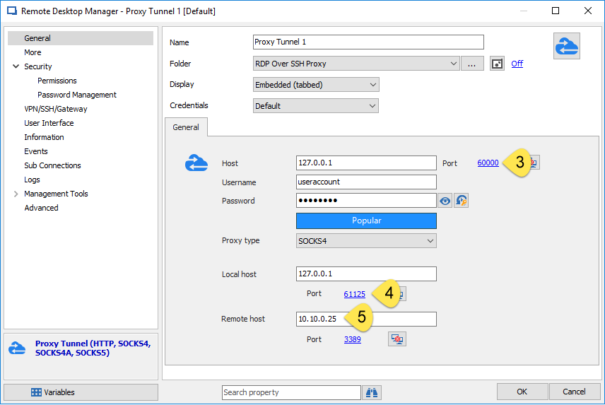

Step 3
Create a proxy tunnel entry for each RDP entry, and bind the RDP entry to the proxy tunnel using the VPN settings. Enter the same port number as the SSH port forward entry, and then enter the port number used by the RDP entry. This port number should be unique for every Proxy Tunnel/RDP entry group. Then enter the IP address of the RDP machine.

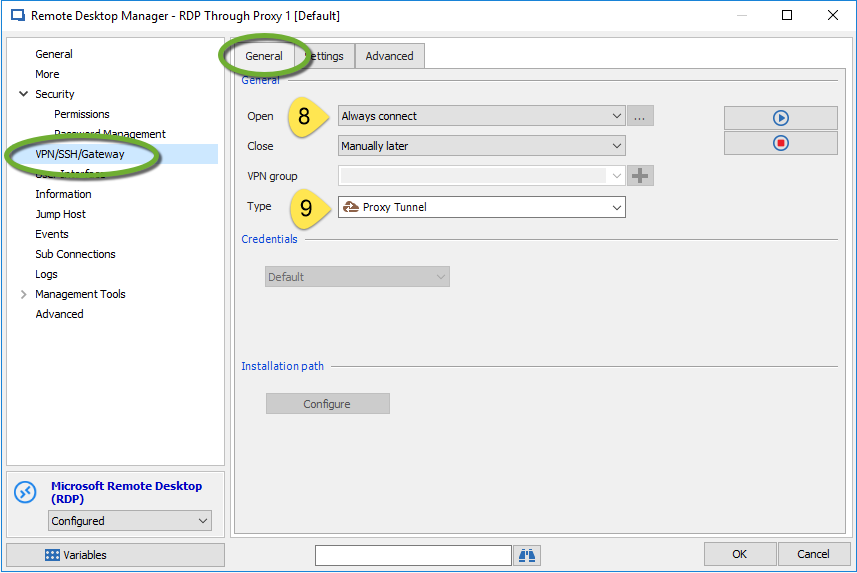

Step 5
In the VPN/SSH/Gatewayside menu, click on the Generaltab and set the following properties: set the VPN Openparameter to Always connect, and set the Typeparameter to Proxy Tunnel.
Step 6
Click on the Settingstab of the VPN/SSH/Gatewayside menu. In the Sessionparameter select the proxy tunnel.
