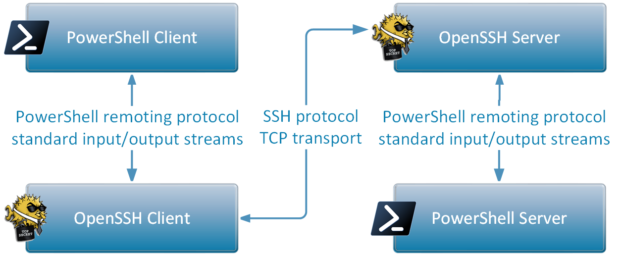

Let’s reveal what happened with the above “Enter-PSSession” command one step at a time, using the following diagram as a reference:
!!PowerShell_Remoting_SSH
PowerShell Client
The first thing the Enter-PSSession command does is find the OpenSSH client executable (“ssh”), which is the same executable we have called for the regular SSH connection. It then proceeds to construct a command-line based on the -HostName and -UserName parameters we passed and launches “ssh” as a child process:
/usr/bin/ssh -l wayk -s localhost powershell
The last parameter, “powershell”, is not random: it tells the OpenSSH client to use the “powershell” subsystem, which is what we configured earlier in the sshd_config file of the OpenSSH server.
Once the SSH connection is established, the PowerShell client hooks the child process standard input and output streams, and uses it as a PowerShell remoting transport. In other words, the PowerShell client does nothing more than read/write operations with the OpenSSH client child process beyond this point.
OpenSSH Client and Server
The OpenSSH client connects to the OpenSSH server, but instead of requesting a regular system shell like bash, it requests the “powershell” subsystem. The OpenSSH server finds the command-line associated with the “powershell” subsystem in the sshd_config file and creates a child process with it. The OpenSSH server then hooks the child process standard input and output streams and relays all data sent over SSH directly into it. This may look familiar because the same strategy is used on the client side.
PowerShell Server
Let’s go back to the PowerShell subsystem line to take a closer look at it. We already know that this line tells the OpenSSH server what command to execute for SSH clients requesting the “powershell” subsystem, but we don’t know more than that.
Subsystem powershell /usr/bin/pwsh -sshs -NoLogo -NoProfile
The important part in the above command is the “-sshs” option that tells PowerShell to run in “SSH server mode”. If you run the same command in a regular terminal, you won’t see the regular PowerShell prompt, and pressing enter will throw an error:
wayk@pwsh-demo:~$ pwsh -sshs -NoLogo -NoProfile
An unknown element "" was received. This can happen if the remote process closed or ended abnormally.
This is because PowerShell in SSH server mode expects to exchange the raw PowerShell remoting protocol (also called MS-PSRP) over its standard input and output streams. You can try typing random text, which will result in another error, because we are not giving the process valid PowerShell remoting messages (specially formatted XML).
However, in the context of PowerShell remoting over SSH, these messages are exchanged between the PowerShell client and PowerShell server, both of which expect and understand the PowerShell remoting protocol. This also means that SSH doesn’t really know about PowerShell: it just requests the “powershell” subsystem by name and the OpenSSH server calls the associated command-line.
