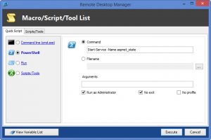

In this example we want to start as service (say ASP .NET State Service). First select PowerShell and enter the command Start-Service -Name aspnet_state, select Run as Administrator and execute.
Quick Script
  • Quick
  • Logged
  • Limited functionality
Script/Tools
  • Must be predefined
  • Logged
  • More advance (supports Run as a different user for example)
  • Runs within RDM
