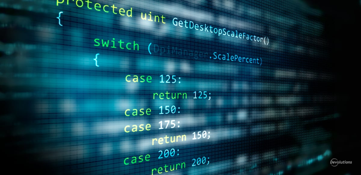

Next, I checked the RDP protocol specifications to get more details and it was exactly what we wanted. We needed to specify the desktop scale factor and the device scale factor:
protected uint GetDesktopScaleFactor()
    switch (DpiManager.ScalePercent)
        case 125:
            return 125;
        case 150:
        case 175:
            return 150;
        case 200:
            return 200;
    if (DpiManager.ScalePercent > 200)
        return 200;
    return 100;
