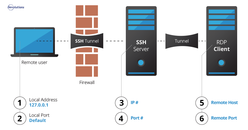

To create an SSH tunnel, a given port of your local machine needs to be forwarded to a port on a remote machine, which will be the other end of the tunnel. This is the job of the SSH Server. Once the SSH tunnel has been established, the user simply connects to the local end of the tunnel in order to access the remote host transparently.
This might sound more complicated than it is — so let’s look at a concrete example of how to set up an SSH Tunnel. Let’s say you’re the IT technician at your office and need to connect to a client through an SSH server to perform work using RDP, but (there is always a but) it is protected by a company firewall. You need to get through the firewall in order to perform your work. The solution is to create an SSH Tunnel in Remote Desktop Manager to carry the RDP communication.
SSH Tunnel Diagram

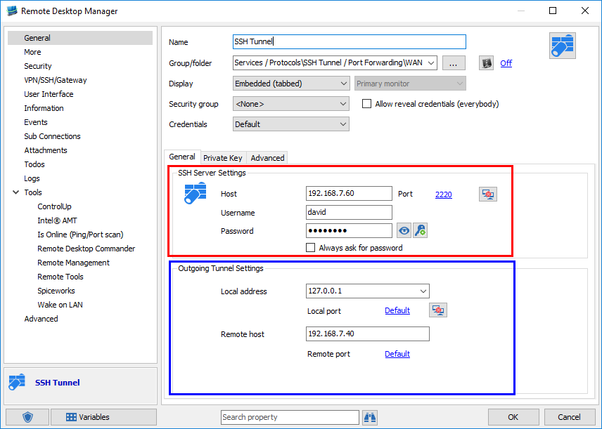

Start by creating an SSH Tunnel entry in Remote Desktop Manager.
Configure ssh tunnel remote desktop manager rdm devolutions
In the SSH Server Settings, enter the following information:
Host: Enter your SSH Server host or IP address (please refer to (3) in the SSH Tunnel diagram).Port: Enter your SSH Server port (please refer to (4) in the SSH Tunnel diagram). Username: Enter your SSH Server username to connect. Password: Enter your SSH Server password to connect.
In the Outgoing Tunnel Settings, enter the following information:
Local address: 127.0.0.1*(please refer to (1)* in the SSH Tunnel diagram). Local port: Use any unused port that you prefer, but RFC6335 states that the Private Port range is from 49152 to 65535 (please refer to (2) in the SSH Tunnel diagram). Remote host: Enter the host or IP address of your remote host (please refer to (5) in the SSH Tunnel diagram). Remote port: Specify the appropriate port for the chosen protocol. For instance, RDP’s default port is 3389 (please refer to (6)in the SSH Tunnel diagram).

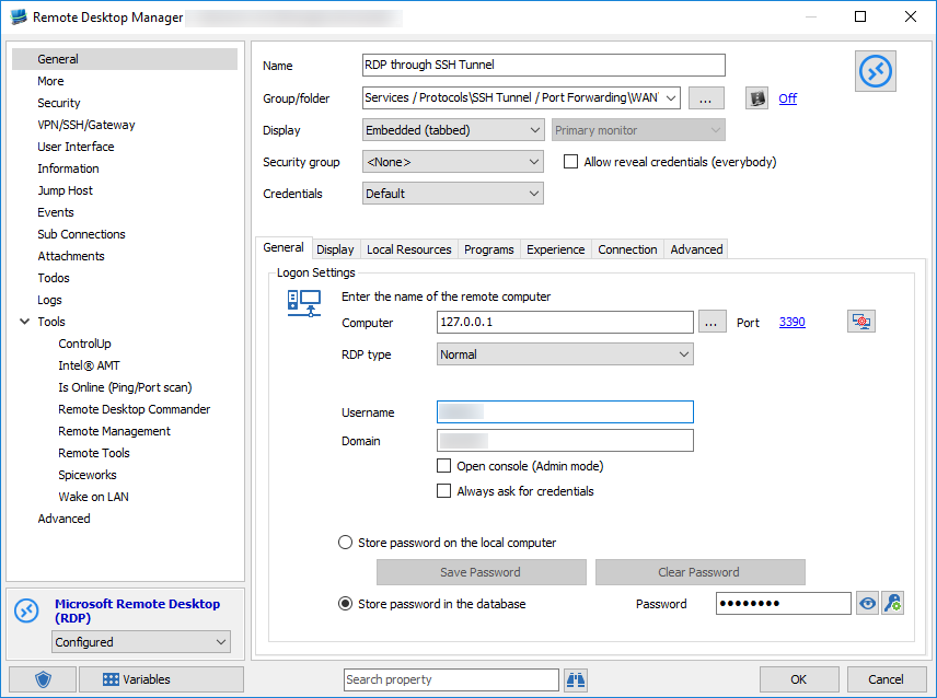

Then create your remote session (in this example we will use an RDP session).
In your RDP session, enter the following information:
Computer: Enter your Local Address (please refer to (1) in the SSH Tunnel diagram)– 127.0.0.1 Port: Enter your Local Port (please refer to (2) in the SSH Tunnel diagram) – 49152 Username: Enter the username to connect to your Remote Host. Password: Enter the password to connect to your Remote Host.

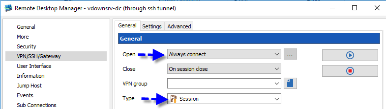

In the VPN tab of your session, in Open, select Always connect; in Type, select Session.

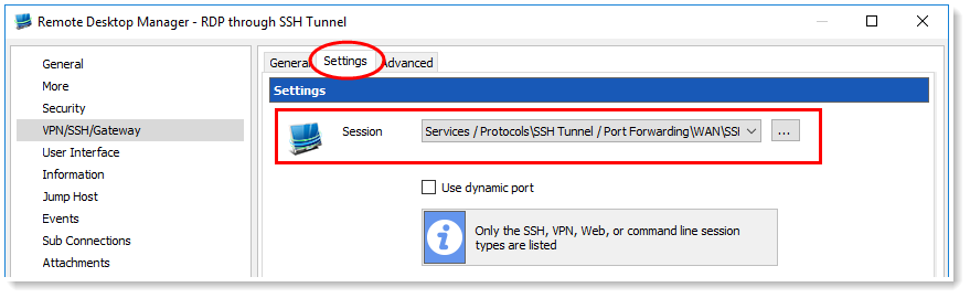

And finally, in the Settings tab of your VPN, simply select your newly created SSH Port entry.
You have now configured your session with the following rule: for each connection that comes on interface 127.0.0.1 and port 49152, forward that connection to the SSH server and request the server to forward that connection to your Remote Host.

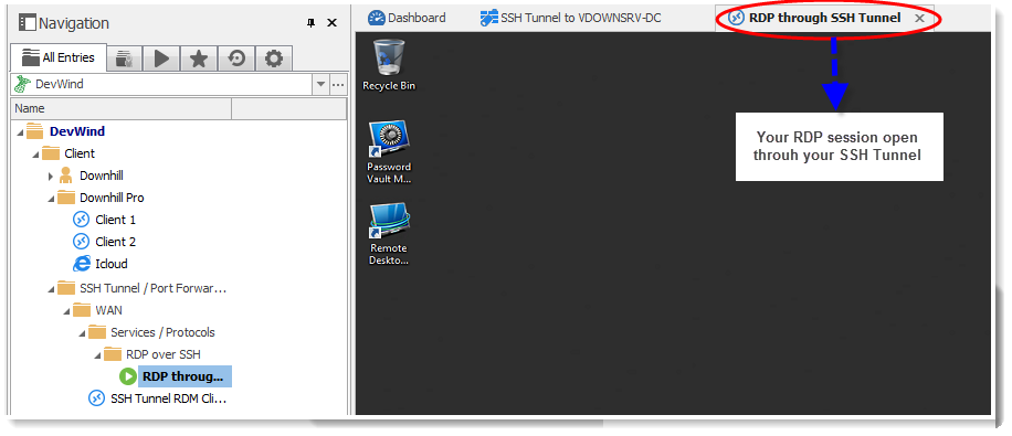

You can now launch your RDP session and your SSH Tunnel will automatically open, establish the connection, and then launch and open your RDP session.
