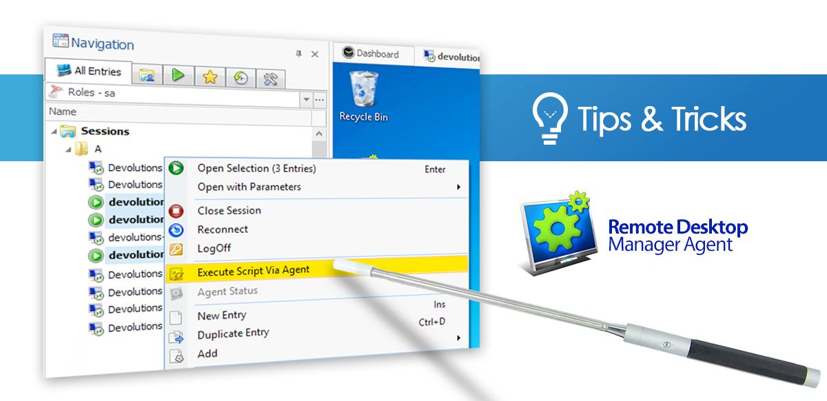

Do you ever need to run a PowerShell script on multiple machines? Say an upgrade script? RDM Agent is the tool for the job. First open an RDP connection to all the machines you want to execute the scr...
Photo of Max Trottier Max Trottier
Do you ever need to run a PowerShell script on multiple machines? Say an upgrade script? RDM Agent is the tool for the job. First open an RDP connection to all the machines you want to execute the script on. Once opened, multi-select the opened session right-click -> Execute Script via Agent. Select the script type, set the script parameters and hit Execute.
